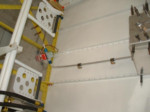

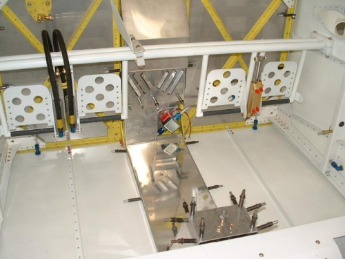

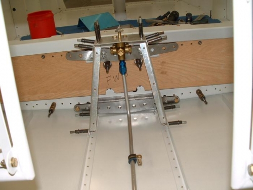

Brief Description:  Fuel line/center tunnel
Today I picked up where I left off last weekend. I fabed the fuel line that runs from the selector valve to the pump. I installed some standoffs for the adel clamps that secure the fuel line. I also started fitting and drilling the center tunnel cover. I decided to use the one that I bought from Vans instead of making a new one. Since I don't have a metal break here at the house it would have been too time consuming. The Vans one will work, it's just VERY thin. The first foot that lands on it will probably destroy it... I will probably end up making some kind of removeable floor panel to go over the top of it.
