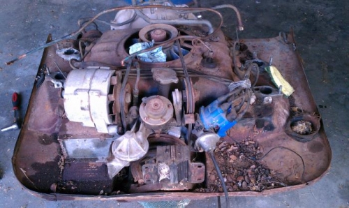

Picked up engine core from Classic Street in Taylor Texas.
Engine is a 1964 164cc 110hp 'YN' series engine (SN: T0830YN) with a manual transmission bell housing. Even tho it is a 1964 model, it has the '8409' crank in it which makes it the same as the 'RD' model that came out in 1965. This is a perfect engine for a aero conversion as per William Wynne's Conversion Manual.
One negative is that it did not come with a harmonic balancer. It had an A/C pulley instead. Will likely need to get one from Clark's (C9871R $225)
One positive note is that it did come with a '12 plate' oil cooler. Even tho a replacement from Clark's is only $120, they seem to be pretty much out of stock on both the new and used varieties of both the '12 fin' and 'folded fin' types.
Original condition (rear)

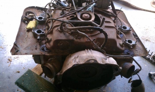

Original condition (front)
