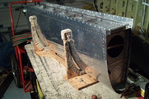

Brief Description:  Completion of Right Wing tank
Long day today, spent it entirey building the Right Wing tank. The rear flange went on so smoothly and the Pro Seal looked so perfect, too perfect. I realized that I had not installed the "z" angles from the Spar.
When I went to transfer and mount them, I found that I had not back drilled the holes out on the "z" angles from the rear flange.
Took it all apart, cleaned and re did the whole thing. Done now though, and I do hope I never see Pro Seal again. That stuff is not nice, so sticky it gets everywhere.
Tanks all done both sides, the wings will go out to the shed now till Spring as I concentrate on the fuselage and engine.
Wow thiis thing is getting exciting, I could have sold the whole thing in mid afternoon when i realized that mistake. All is well now so lets see if we can get this thing built this winter.

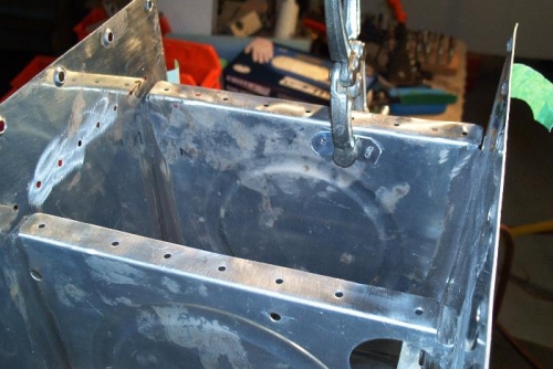

Closed off Tooling hole in outboard 704 rib

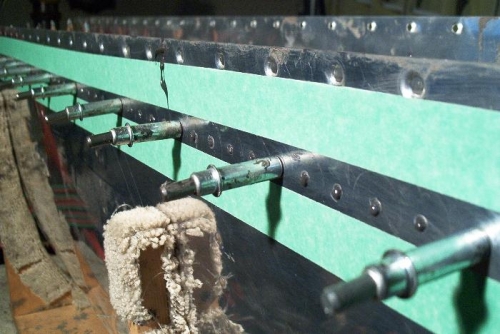

Nice squeeze of Pro Seal out all holes
Completed and cleaned
