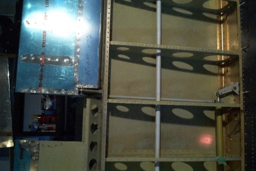

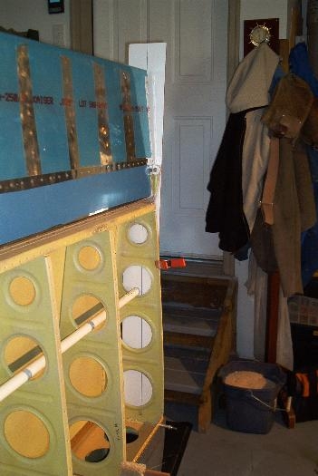

Brief Description:  Completion of Aeirlon and installation on wing
Completed the installation of the aeirlon today. First I riveted the rear underneath portion of the skin to itself and the outer ribs A-705. Went well and the unit becomes incredibly strong. I then installed it on the wing with the correct washer assortment and then torqued to 20 inch pounds.
Connected the push tube from the cabin and checked for smoothness. Very nice!
moving on to the installation of the Auto pilot servo.
White lateral is PVC conduit
