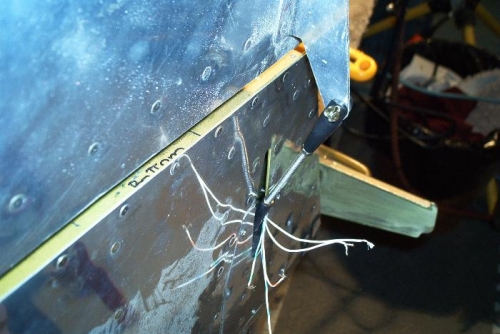

Brief Description:  Left Elevator
Took a few hours out today to install the pushrod from the Trim Tab servo. Left lots of pushrod inside the clevises if needed. Installed the cotter pins in both ends. and locked the pushrod in with the locking nut. Had to cut a small chuck out of the lower skin to allow the servo to slip inside the elevator.
Went well and tried the servo motor out , first animated moment for FDJC as it begins life!

Side View of servo pushrod
Top View of Trim Tab install
End View of Pushod install
