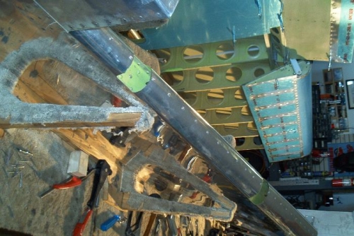

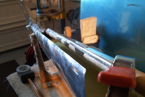

Now for the rudder, to begin I have wanted to close off the rolled inner section of the rudder since completing it some 3 or four years ago.
I began trying to tape and roll the entire length of the inside rudder only to find out it would not work as suggested in the manual. I then taped only a section at a time and that was the answer, it went along nicely after that and as seen in the pictures I even placed the top on the rudder.
I have left off the bottom section as I havent decided on lights and the manual says that you should wait until the empenagge is joined to the fuse to make any necessary adjustments.
rolloing the inside edge  of Rudder

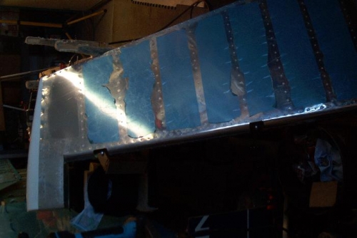

The inner rolled edge complete
The complete rudder including top
