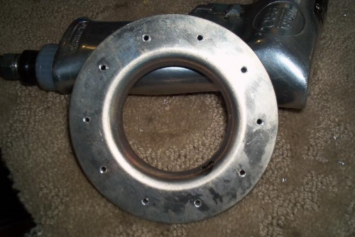

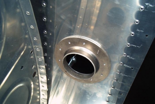

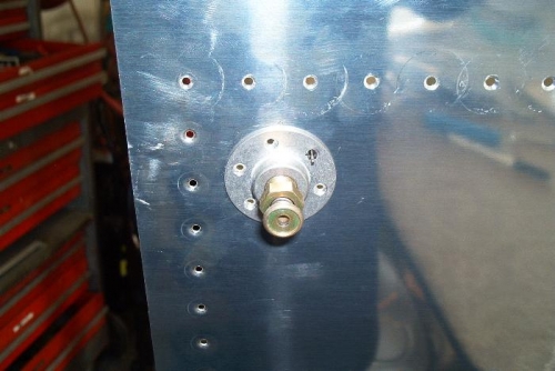

Brief Description:  Installation of tank Stiffeners, drain and filler
Installed the stiffeners to the right wing skin and the drain and filler tank flanges to the skin as well.
This was a pretty good session although these tanks are to say the least tedious and painstaking, that said though. I have taken all th precautions i can and every rivet was washed and every part was wiped with a Naptha soaked rag to clean all parts first. Then I dabbed the rivets holes with a bit of Pro Seal to ensure that when the rivet went into the hole it had some Pro Seal to work with, this made for a messy clean up but I quite confident that all holes should seal up well and they shouldnt leak
Well next session will be to put the ribs into the right wing and Pro Seal.
