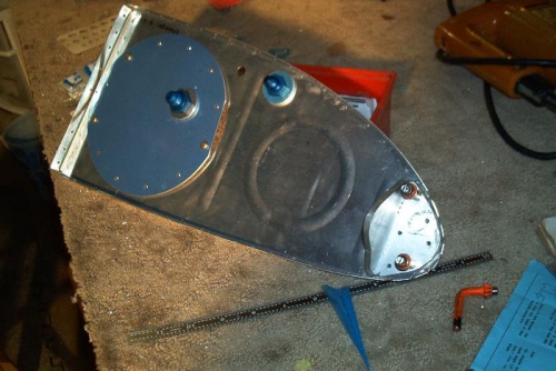

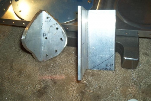

Completed the fabrication of T 403 Angle, had to read a lot as the instructions were not very good on what it was going to hook up to also the drawing noted R1 yet did not instruct as to what R1 was I took it to be a radius as determined to make a bell shaped curve. Reading I found that a Steel angle will match with it when installing the wings to the fuse and therefore some "fudge for fit" might be possible. With this in mind I installed it 2 inches aft of the front of the rib. See pic number 2.
Begins as angle on left
2 inches aft of the nose
Completed installation of T 403
