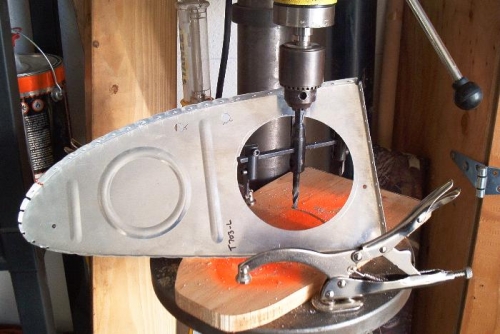

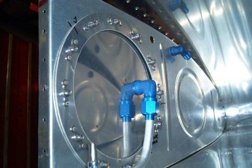

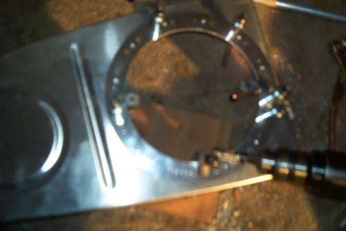

Decided to do both the inside rib Access plates to the tank. This involved using the fly cutter, and then deburring the ring to accept the countersunk rivets holding the nutplates on. The countersinking was done with a little tweak to my stop and this made a much nicer flush rivet on the left tank. The right tank came out ok too but the left tank rivets were a little more flush. Any amount of space would be taken up with the Pro seal if I choose to use it, but at this point I dont think I will in case I do have to make an internal inspection of the tank sometime.
Some time out this week to install a garage furnace,, aahh the warmth.. so nice!
My Fly cutter and teh results
Drilled the nut plate holes
an inside tank look at the work
