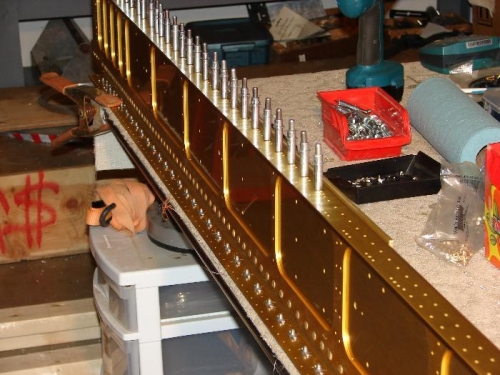

Brief Description:  Preparing the Spar for the wing tanks

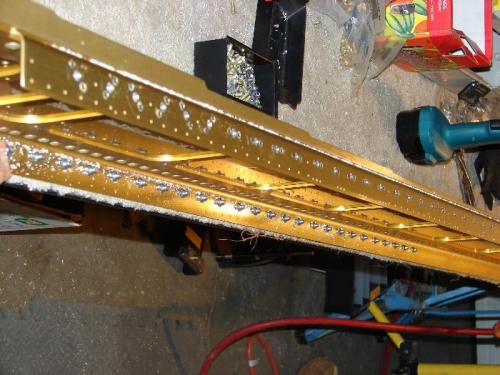

Completed the left wing spar riveting of the platenuts for the wing tanks. This went really well, the countersink was a bit of a challenge to get it right but i started out light and then diald in the correct depth testing it with a #8 screwhead that I had cut off.
I have to do the other side now as all the countersink cages are set and ready to go.
Platenut installation on wingspar
Riveting the platenuts on
Countersunk and complete
