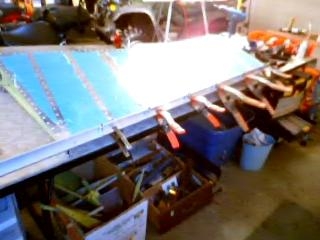

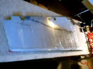

Brief Description:  Rudder trailing edge couterbalance

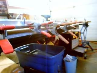

Clecoed the counterbalance and 901 skins together and radiused some edges to allow for a smoother transition of 901 to counterbalance skin.
Mixed glue and placed on the V strip trailing edge piece, man this is sucky stuff, it went on and when i put it together it appears be ok. I will see how this looks when i put the rivets in to the holes and set them. | put some boeing lube in thehole to allow for a good fit and no chance of plugging the hole.
