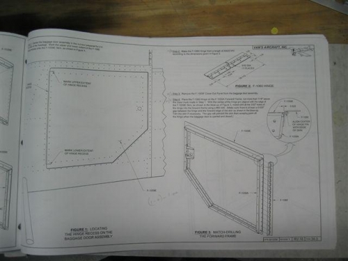

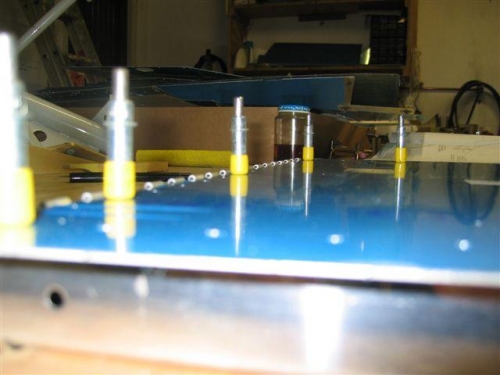

Mark hinge upper and lower points on baggage doorMeasure and cut hinge. Then measure and drill #40 holes in intervals as per plans.Clamp the hinge in place on baggage door as per plans. Matchdrill the holes.
Hinge half a hole proud
