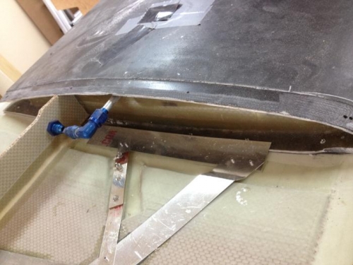

Brief Description:  Fitting right winglet
Began fitting the right winglet. The skin of the winglet and the end of the wing were both too thick to accomodate each other into the joggle, so some grinding and reinforcement was necessary.
Built a cradle and frame to hole the winglet in place at proper angle during construction. Drilled pilot holes for Clecos to hold it rigid.
