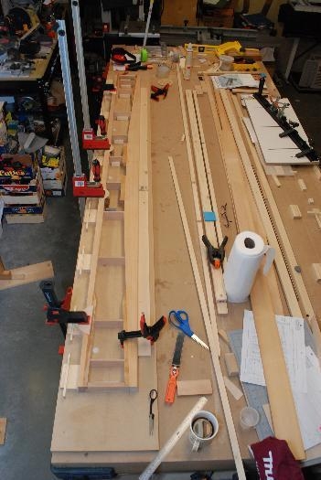

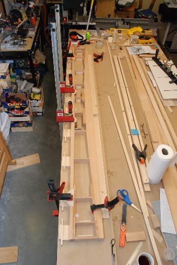

Brief Description:  Dry fit of the second front center section spar fl
Dry fit of the second front center section spar flanges and intercostals in the jig. Prepared jig with paraffin emulsion under areas to be glued. The Anchorseal Paraffin emulsion was applied to areas of the jig that will be under the epoxy. This must be buffed once dry so that there is no transfer of the water based emulsion to the wood.
Purchased wood for the outer wing panel spar jigs.
