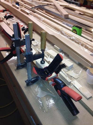

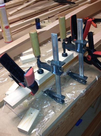

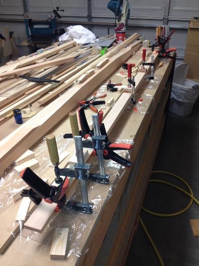

Brief Description:  Center Section Front Spar Lower Flange
Planed, and cut new lower flange for the front center section spar.
The original upper center section spar flange had an imperfection. The original lower flange had a few acceptable very small pitch pockets. I have chosen to recut this, as I recut the top flange last weekend that was from the same wood.
Glued the center section lower rear spar flange with T-88 in a u-TAH cartridge. (addition on 1/18/12 it worked this time, doing all the things I did the next day when it did not)
Right front center section lower
Center section front lower spar flange
Left front center section lower spar flange
