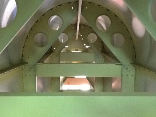

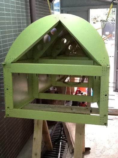

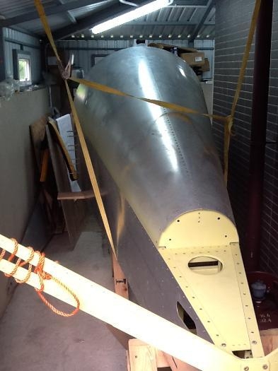

I clecoed all the turtle deck piecs back together ready for rivetting. It all fitted again well. Once clecoed and checked for levels I commenced rivetting the outerskin then the formers and angle pieces.It all secured together nicely. The structure really takes strength. there was very little dimpling of the skin which I was concerned about so this is a good result.
Rear fuselage Primed and rivetted
Inside rivetted formers and crossties

Dimple free turtledeck
