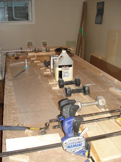

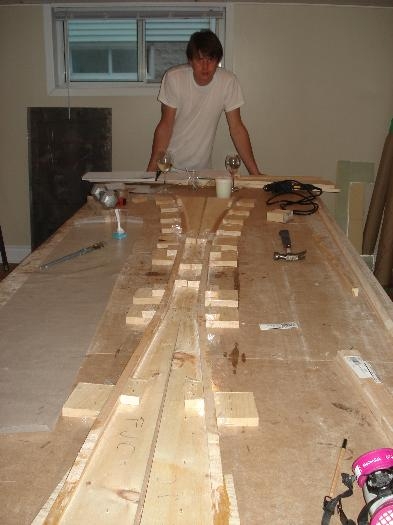

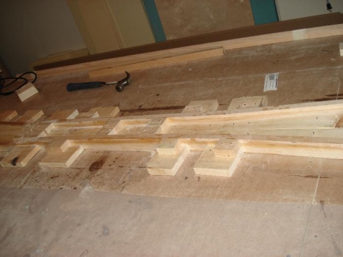

Added the doublers to the longerons. The plans call for drilling out holes in the doublers and nailing them down to the longerons. This didn't seem wise to me so I just used more blocks to forms the curve. Them I wieghed down the whole operation. It all came together nicely.
