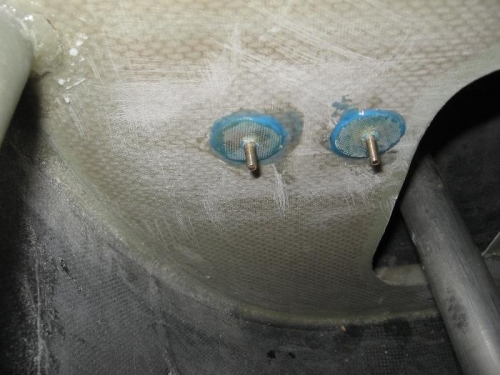

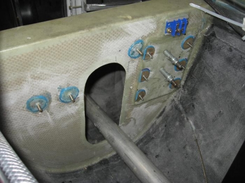

Brief Description:  installation of yaw damper & pitch a/p servos,
counter sund phenolic cut-outs for a/p pitch & yaw damper servosput screws in phenolic & floxed into place to make screw on hard-pointscut pre-lam to make washer to fit over new hardpointsbonded washers into placecut pre-lam to make bonding panel for auto trim boxesbonded 6 EZ points onto board, cut EZ points to fit boardcut 2 small pieces of skin out from bulkhead to accomodate nutplatescored & micro-ed 2 cuot out areaslaminated 1 BID over micro to make a hard are for nutplatesbonded panel in place w/ floxmad a small grounding terminal from pre-lam & electrical terminal block & bonded in place w/ flox
