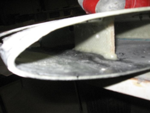

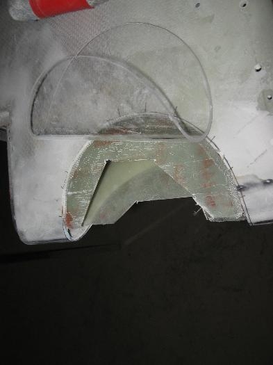

Brief Description:  LH wintip landing light
released lens & trimmed flangefabricated nutplate bracket for landing light mounting platebonded nutplate bracket to landing light mountcut out LH wingtip lens and sanded carefully to shapefabricated bulkhead for mounting landing light mounting plate from 1/4" honeycombhardened mounting holes after drilling through bulkheadbonded bulkhead in place using flox
