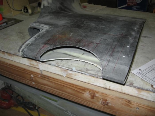

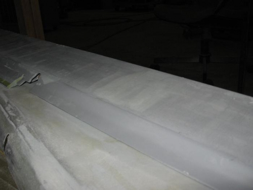

Brief Description:  finished aileron bodywork, started landing lights
finished bodywork on aileron bottomslaid out cutout in RH wintip for landing light installationcut out area and sanded to proper shape & contourcleaned up inside area and applied micro to inside surface to create uniform thickness
