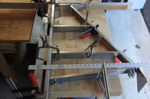

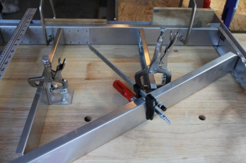

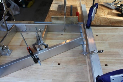

Positioned spars and ribs into jig and measured to confirm squareness and dimensions were as per plans.
Starting with the root rib, I began drilling the rib rivet holes to the clips at both ends - using the clip pilot holes.
I then moved to #2 Rib positioning the rib aft bend center aligned with the holes located in the Main Spar Fwd Strap ensuring proper sqaureness via the jig angle bracket and clamp. Moving to the fwd end of the rib the bend tab was centered overthe Fwd Spar rib pilot holes and drilled to #40.
The same process was repeated on Rib #3.
Lastly the tip rib was drilled into place using both of the spar bent tab pilot holes
