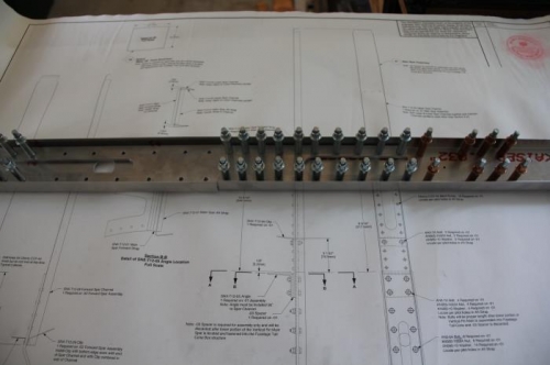

Created the Main Spar assembly by positioning and drilling to #40 the following T12 pieces:
T12-03 Upper Main Spar Channel
T12-04 Lower Main Spar Channel
T12-01 Main Spar Aft Strap (included in kit)
T12-02 Min Spar Fwd Strap (Angle kit piece purchased)
