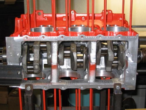

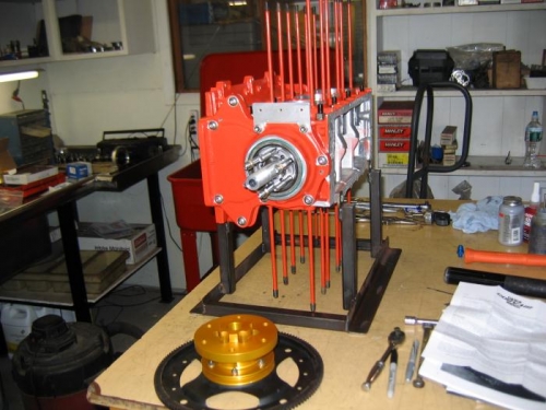

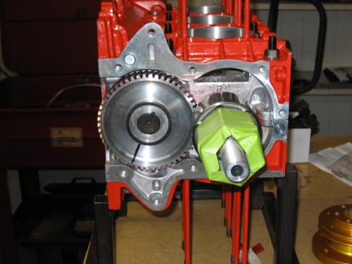

The bearings arrived today so we were able to close the case, torque the ARP case bolts and install the Weseman 5th bearning. In terms of mic'd dimensions, backlash, and rollout everything is looking really nice and smooth. After that, we added the ring gear and prop hub. Mark milled the Weseman 5th bearing cover for the Alternator mounting bracket. He also installed the cover case alignment dowl and the oil fitting. We discovered that the oil pan was not constructed properly. So when I got home I ordered a WW Gold Oil pan
