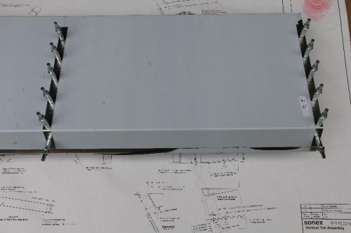

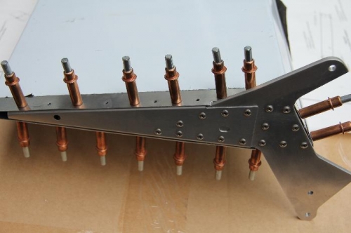

Rudder Rib Rivet Holes
Created rib rivet template
Marked and drilled to #40 rib rivet hole locations skipping the center rib hinge hole .This will be drilled when the hinge is positioned on skin for riveting.
Removed rudder skin protective coating along rib rivet lines and hinge mating surface
Ribs cleco'd in place
Drive horn updrilled
Hinge cleco'd in position
