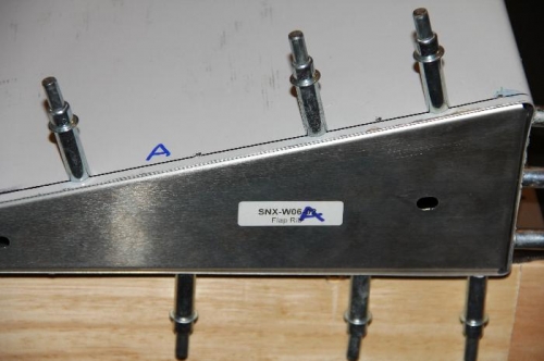

Located, marked and drilled #40 the rib rivet holes on the left and right flap skins
"Blue Lined" the drive plate ribs and remaining ribs for match drilling
Matched drilled to #40 the drive plate rib and remaing ribs for each flap
NOTE: I skipped over the rib holes that also line up w/ the hinge
