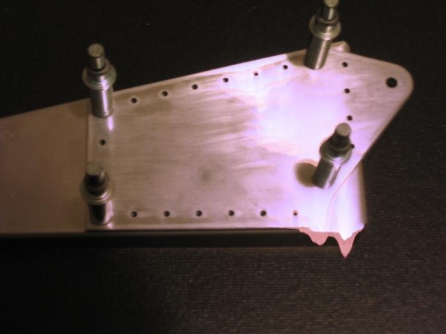

Used a unibit to enlarge drive plate flight control linkage pilot hole to 3/16" size on each plate.
Positioned flap drive plate on to rib to for each flap then drilled #40 size rivet holes in each plate and respective rib.
Next I enlarged the rivet holes to #30 then deburred the holes on the plate and ribs.I sanded the drive horn plate.
Finally I riveted each drive horn plate to it's respective rib completing my first assemblies!
3/16" and #40 size holes complete
