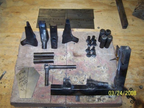

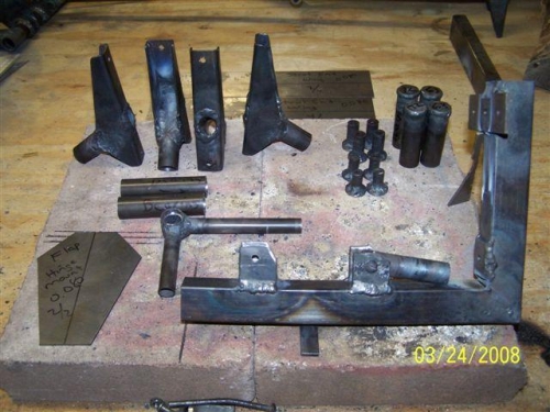

Brief Description:  Aileron/Flap Hinge Mounts
Match drilled flap hinge mount brackets. Drilled hole for tubing to go through brackets and used dremmel to enlarge so tube sits at correct angle. Reamed mount tubes to 5/8". Welded the 0.062 mounts. Cleaned slag with 5/8 bit. Bearing slides in snugly. Sure seems like I did more. These were actually fun to make. Felt like I accomplished something.
