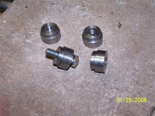

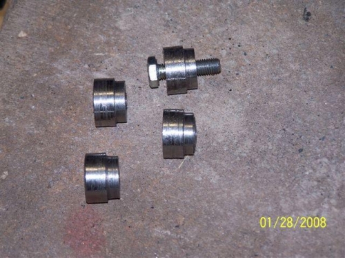

Wing Root Flap Torque Tube Support
Turned and threaded caps for root support.
4 caps
0.5" wide total, step is 3/16"
Fitted inside 3/4"X0.049 4130, slip fit
