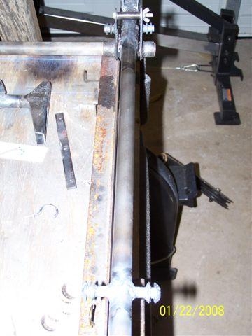

Welded flap torque tube support bearing to second flap support. Used same procedure as before. Spins smoothly.
Drilled hole for 3/8" x 0.058 spring attach points in support tubes. Finished welding one 3/8" attach tube and retainer washers to one tube. Ran out of acetylene. Done for today.

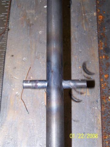

Spring attach tube.  Nice and normal to main tube

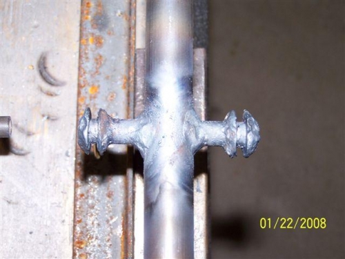

Finished welding spring attach point
Close up of attach point (before cleaning).
