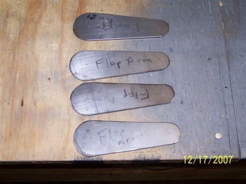

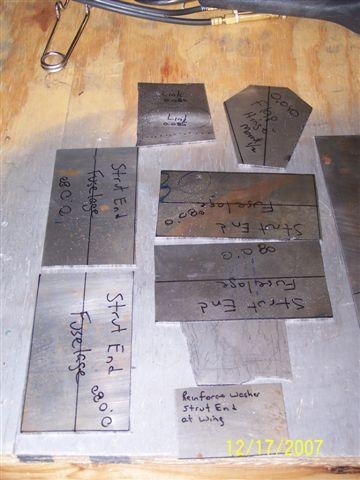

Cutting the 0.080 4130 sheet with my bandsaw (metal) took a long time. I kept knocking the blade off.
The flap arms should have had the 3/4" hole cut before I cut them from the sheet!! Now I've got to figure out how to hold them solidly while I use the 3/4" hole cutter. Can't see it in the picture but the Flap Arms are center punched for the holes.

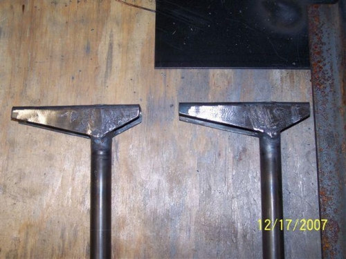

Welded #2 end on Support arm, shaped the flap arms and cut the misc 0.080 pieces from the sheet.
Flap Arms - without holes.
Misc. 0.080 parts
Misc. 0.080 parts
#2 Ends on the Elevator Supports
