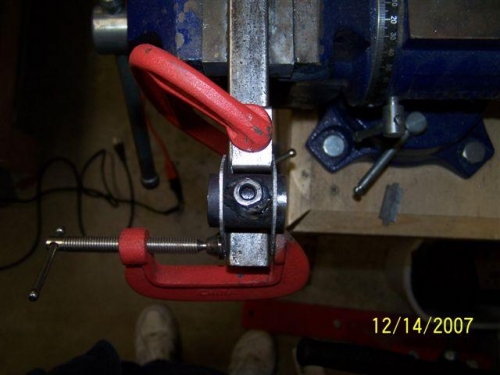

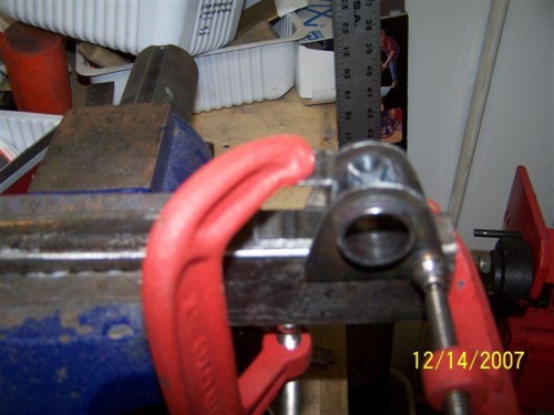

Brief Description:  Flap Torque Tube Bearing
Setting up the support for welding. Used square tubing cut square on one end to make sure the bearing was square to 3/4 support tube for easier setup for welding. Used a dremmel with abrasive tube after welding and the 3/4 tubing turns nice and free. Not too happy with the appearance of the welds after I finished so I may end up remaking these.
