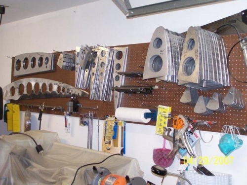

fluted nose ribs. made new master form block with router and flush cut router bit. Cut lightening holes in tip ribs.
