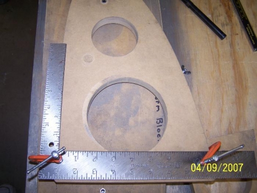

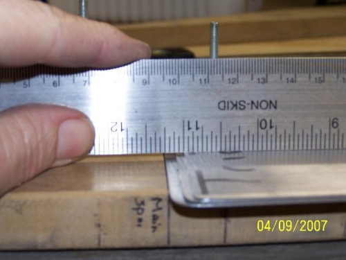

Center Rib Fitting
Trimmed 1/8" off trailing edge of center ribs. Trimmed form block using square to trim 1/8" off and used router method to trim ribs. Fast, easy and accurate.
