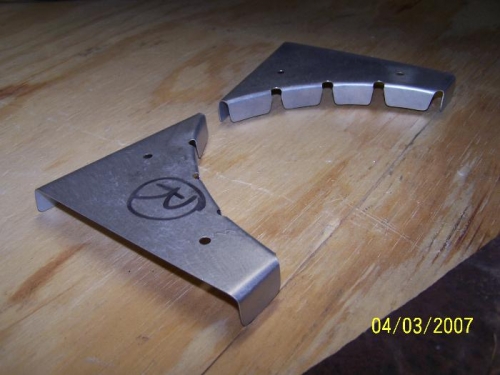

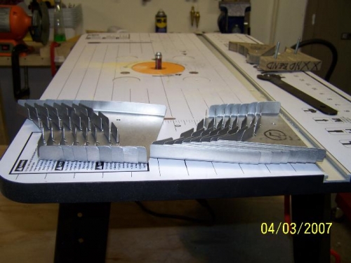

Aileron Pocket Ribs
Measured the aileron pocket ribs from the master form block. Allowed for thickness of back cap strip and rib attach angle. Did this to avoid problem that some have had with big gaps at pocket ribs.
