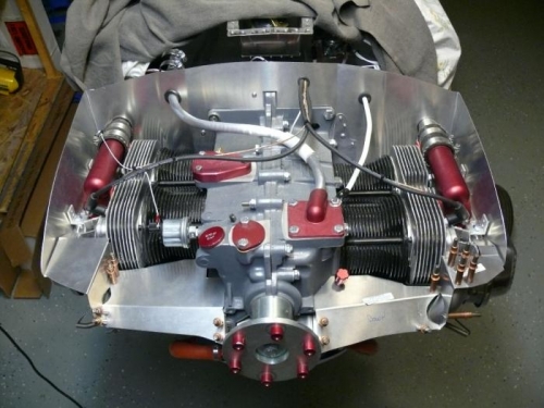

Tonight started cleco'ing together the baffle parts. Up until now, all work was just trimming and fitting without drilling any holes to hold it all together. Tonight continued the trimming where required, but also cleco'd just about everything together.
The front pieces (6) can be riveted together. The can be removed from the engine as one assy. They are then held to the side pieces, which are held to the back piece, by self-tapping screws to allow removal of the side pieces for maintenance work (like retorquing the head bolts).

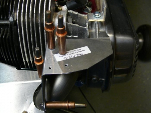

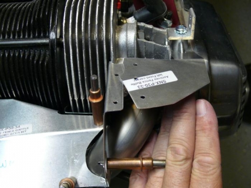

The left front (right side in the pics) piece created some problems. As per the plans, there was no way it would fit, so I cut it into two pieces. This allowed a good fit, but created a gap as shown in pic one below. I created a filler piece shown in pic 2 to solve that issue. Also spent quite a bit of time creating a tie-strap for the front lower side in this same area; the pieces were close, but no overlap for riveting, so I custom-fit a strap to hold them together.

What was one, had to be cut in two
Created filler piece
Overall shot of baffles in place
