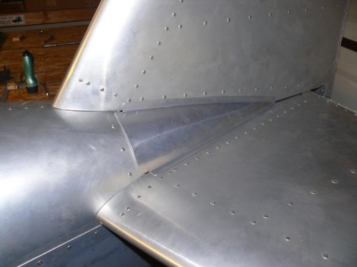

Used a rolling pin to bend the curvature of the tail fairings. Then bent the attach angles on both pieces. The attach angle "angle" varies from front to rear, so this took several adjustments to get just right.
When installed, the front edge of the fairing will be installed *under* the aft edge of the turtledeck skins.
