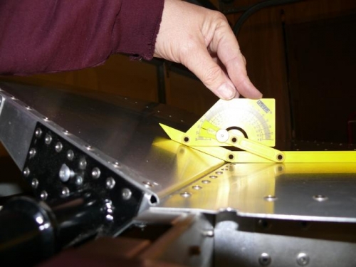

Continued to file the elevator control rod bellcrank to allow 25 deg up deflection of the elevator. One final trimming got it just right (pic 2). Protractor shows 160 or 20 deg; this is because of the tapered angle of the elevator (think angle as it corresponds to the centerline of the elevator).

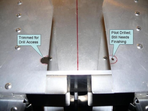

Next, the upper horiz stab skins need to be notched to allow access to the 1/4" drill for the aft mounting bolts. Drilled a pilot hole, then took up to 5/16" with the unibit, then deburred.

Notching for Drill Access
25 Deg Up Deflection
