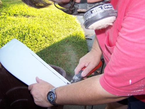

Set up horizontal stab & elevator to accept the fiberglass tip (centered elevator). Pressed in fiberglass tip; seemed to line up almost perfectly wtih the elevator and in comparison to the left side. Only took a slight nudge to get it perfect.
Removed the tip, trimmed away the 3/4" for elevator clearance. Filed the edge of the 'glass smooth, and put it into position. As with left side, partially drilled #30 holes thru the skin pilot holes, then removed the tip and finished drilling them all the way thru.

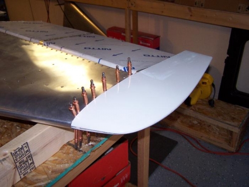

Re-mounted tip and cleco'd into position. Have not yet marked / drilled the holes thru the 'glass into the aft tip rib.
Trimming the tip
Trimming the tip
Cleco'd into position; still have to mark/drill the aft rib
