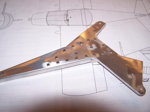

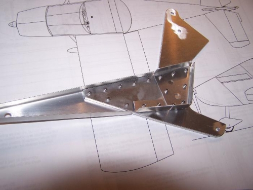

Rudder Control Horn Completed
Completed the rudder control horn assembly. Drilled holes to #30, debured; final debur and cleanup of all parts. First rivets (CCP 44) to put it all together.
