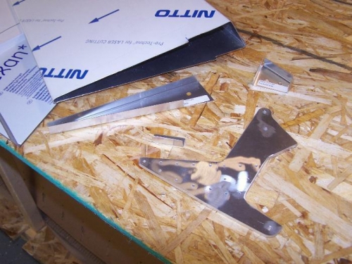

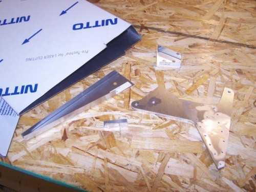

Drilled holes (pilot and 3/16th) in rudder control horn. Fabricated small SNX-T13-06 angle piece from SNX-Z02-03 angle stock. Deburred control horn. Bent to 5.2 degree angle using a neighbor's vise and 3 steel pipe sections. Cut rudder stock to length, then cut angle on bottom of rudder skin along with associated cut-outs for the control horn. Deburred all parts.
