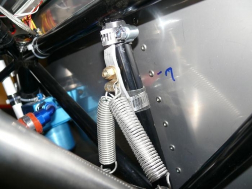

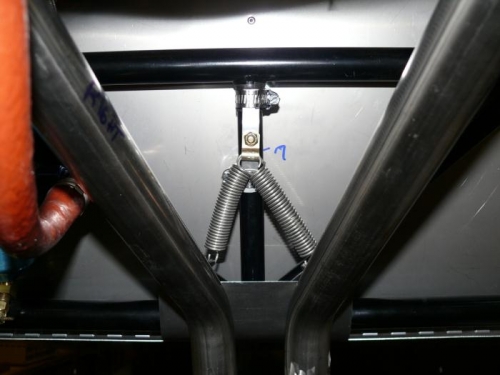

Tonight I only had time for a quick install of the aft exhaust support bracket I fab'd up yesterday.
Wrapped the motor mount with protective tape (thick stuff), I cut two worm-drive hose clamps down a bit to remove excess band material, then secured the bracket in place.
Fastened the springs to the exhaust - had to reposition twice to get them to lay fairly well.
The "7" in the pics is a reference mark I made. Nose-dragger Sonex' don't have the motor mount tube in the way, and so they fasten the clip on/about the 7'th rivet from the lower skin. By coincidence, I'm fairly close without even really trying.
quarter view showing bend in support
view from front
view from front
