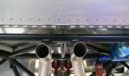

Next up was a shield to protect the motor mount from the exhaust heat. This is not mentioned when you rivet the bottom fuse skin to the fwd fuselage, so you must drill-out existing rivets and re-rivet the shield in place. I measured the area I wanted to protect (no measurements/plans given), cut a scrap piece of aluminum, bent to suit my taste, and did a test-fit. Had to trim it a bit shorter. Measured and marked the rivet holes. Fortunately, these were pre-drilled in the skin from the factory, so they were exactly spaced and even, making the layout of holes in the shield a simple deal.

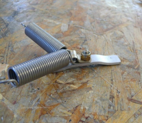

I next trimmed the springs to hold the exhaust extensions to the manifolds. Since I had to trim the length of the manifold for the pipes to fit correctly, I also had to shorten the springs - quite radically in order to allow sufficient tension. Cut 4 springs and installed.
The aft edge of the exhaust must be supported. The plans show a clip being riveted to the firewall, but that won't work in my instance. The picture showed a tri-gear, and I have the taildragger - which has a motor mount brace right where the spring retention point should be. I fab'd a bracket out of 1/8" scrap, bending it to provide relieve for the head of a machine screw. I drilled the bracket and fastened the clip. I will now protect the motor mount and use two hose clamps to hold the bracket in place (don't have the brackets right now...)

Now the shield is installed
Exhaust Support Springs & Bracket
