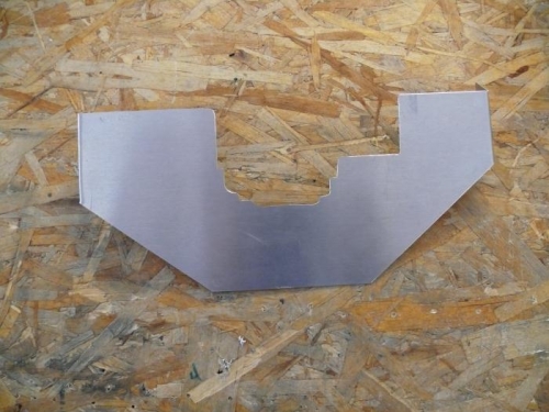

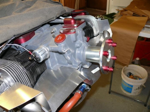

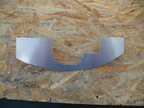

First up was to position the upper oil cooler baffle to determine cowl interference. Quite a bit. Made multiple trim-then-test attempts before finally resulting in the shape in pic 2 below. This is just a bit more trimmed-off than I would have liked, but still can be handled by the rubber gasket material.

Upper oil cooler baffle - pre-trimming
Upper oil cooler baffle - post-trimming
Front baffles bent and just set in place
