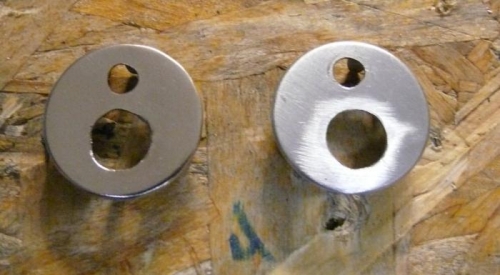

Next, I moved onto the control stick wiring. I'm using the MicroAir transceiver; this was supplied pre-wired for use with my Enigma EFIS. As a result, I have two switches on each stick - one for PTT, and the other for freq swapping.
I'm using foam bicycle grips for the stick grips. On the ends of the stick, I'm using 7/8" hole plugs. I played around a bit with placement of both the small swap button and the larger PTT button and came up with the spacing shown below. The center of the large hole is 11/32" from the edge of the plug, and the smaller hole is 9/32" from the edge.

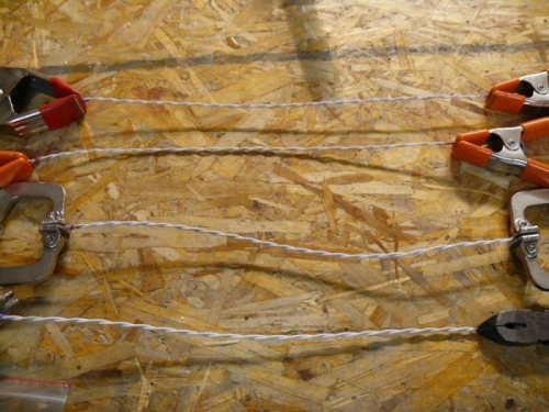

I then made up four harness sets of twisted-pair wire. They probably don't have to be shielded or even twisted, since they only close a circuit when the respective switches are depressed, but since the supplied harness was twisted, I did these as well. Am letting them sit overnight to take a "set."

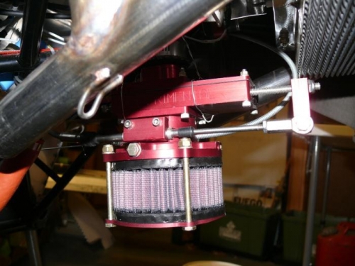

Lastly, I installed a new K&N air filter in the AeroCarb. Although the optional air cleaner assy comes with a paper filter, there has been at least once instance of the paper deteriorating or catching fire, and the engine ingested the remains. I thought I'd go with the K&N before first engine start. I also re-installed the safety wire holding the AeroCarb in place (was removed when I was trimming the intake manifold during cowl fit.)
Control Stick PTT switch caps
Twisted Pairs for Stick Switches
New K&N Filter; Safety-wired carb
