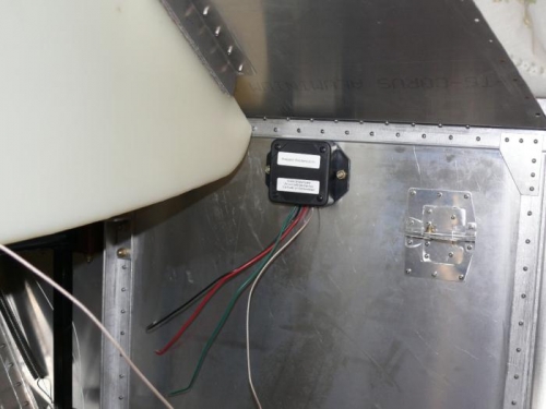

After the plug wires, I located the fuel sending unit logic box. This is a small powered box that takes power and ground from the Enigma secure supply, and fits between the sender and the RDAC. It converts the capacitance from the sending unit into units of measure that the RDAC can convert into fuel level. Mounted it on the right fuse side by the fuel tank. Marked and drilled 3/16" holes and secured with machine screws.
Fuel Level Interface Box on R Side of Fuselage
