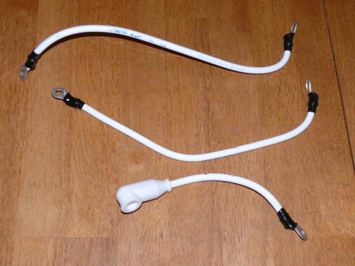

Received the 5/16" battery cable terminal ends the other day, so I swaged them onto the cables - one end of each cable. I'm now done fabricating the cables. All 3 of these are ground cables - from the battery to the firewall ground block, from the starter mount to the firewall block, and from the other starter mount to the engine block. I should have a well-grounded system as a result.

Last of the Ground Cables
