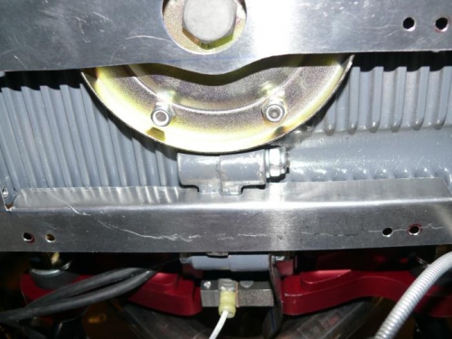

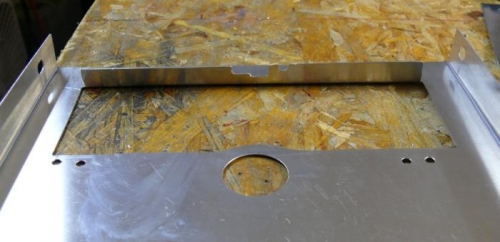

Clamped the oil cooler to the lower case baffle to set the distance from the left exhaust header. Marked location for mounting holes. Removed baffle. Measured dimensions for the cutout to be done at the rear of the lower case baffle for the oil cooler. Cut the baffle. Left 5/8" of the opening remaining, then bent this up 90 deg to form an air dam in the baffle, forcing air down through the cooler. Spent a lot of on-and-off to trim the height of the dam, as well as cutouts in the center to accomodate engine case castings right in the center (visible in the pics below).
Cut a 1/2 moon notch in the forward mounting flange of the oil cooler in order to be able to drain the oil with the cooler in place.

lower baffle in place, w/o cooler to show air dam at back of opening
shot showing trimming of rear air dam
