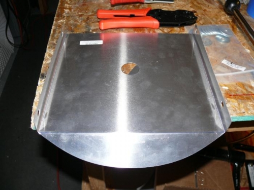

Lastly, the new lower oil cooler baffle arrived today from Sonex, so I bent that into the correct shape.

New baffle bent correctly this time
