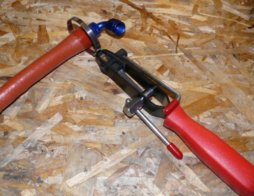

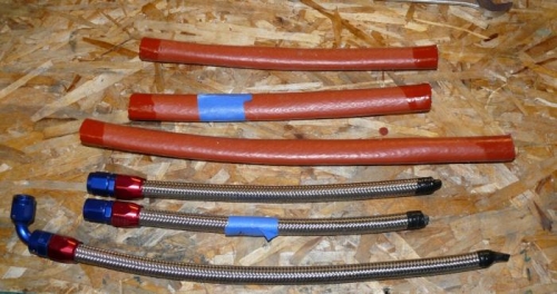

The dipped ends of the firesleeve from last night were all nice and cured, so it was time to assemble the fuel & oil lines.

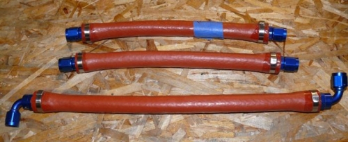

Slid firesleeve onto the target braided lines, then assembled the coupling to the remaining end. Re-positioned the firesleeve into position, then used the appropriate clamp banding tool to add the clamp on each end. Trimmed the remaining ends of the clamps after trimming.

Materials ready for assembly
The firesleeve banding tool in action
Finished Product (blue tape means right side)
