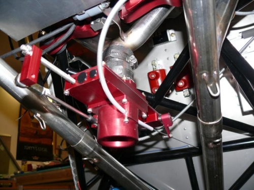

Cut the mixture cable to length tonight and installed. Have not yet used the loctite on the threads of the retainer just in case I need to fine-tune the cable position.
Next, I cut a rough end off of the 6' length of braided fuel line I obtained last year, and installed an aeroquipt 90 deg fitting on the end.
Cut the other end to length. Did not install the fitting on the other end because I am going to install firesleeve on the line, and I have not yet treated the ends to prevent wicking.
Installed mixture cable
